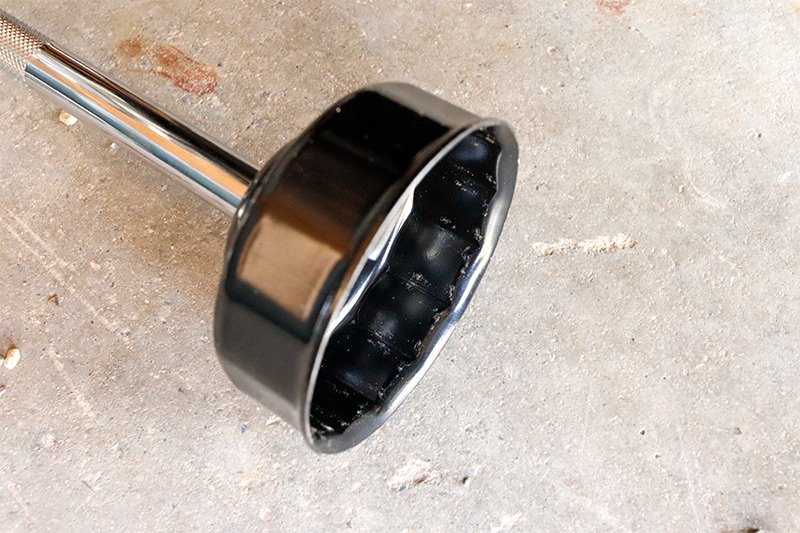

Next, I needed to buy an oil filter wrench. I ordered one from Amazon for $8.99 with free shipping because I have Prime. This is the exact part:
EWK 3/8 inch 64mm 65mm 14 Flute Oil Filter Wrench for Toyota Scion Honda Lexus
I can confirm that this filter wrench fits the Polaris oil filters.

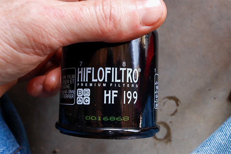

Finally, I bought an oil filter from Amazon too. Here's what I got:
Hiflofiltro HF199 Premium Oil Filter
This is a knockoff Polaris filter that fits these ATVs. It replaces the Polaris part numbers 2520799 and 3089996. I can confirm that this filter does indeed fit as well.

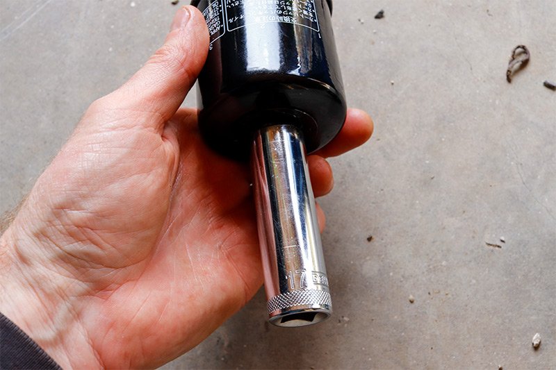

The only tools necessary to do the oil change for this Polaris Sportsman 850 are the oil filter wrench I described above and a Torx T40 wrench. If you're going to buy the same replacement oil filter as I did, you'll need a long 17mm socket or a short one with a socket extension.

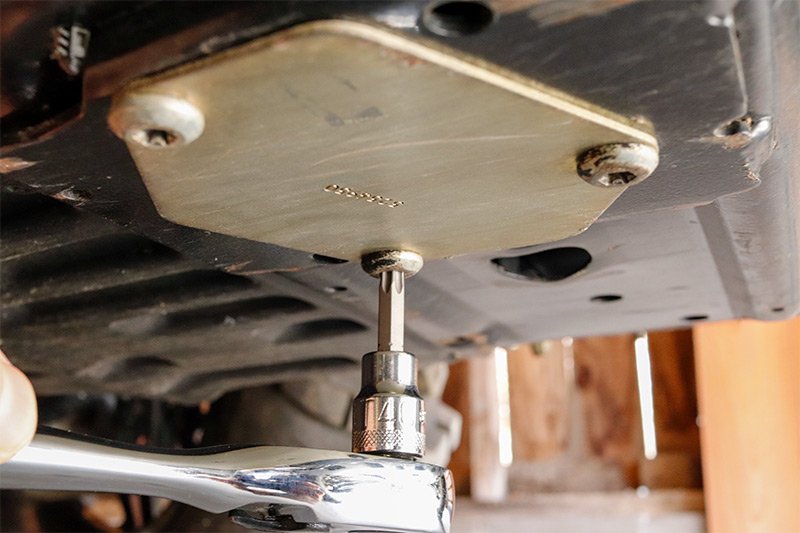

1. First, I used the Torx wrench to remove the bottom plate on the quad.

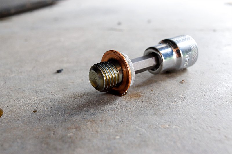

2. Then, I used the same Torx wrench to remove the oil drain plug. Before removing the plug, I place an oil catch under the drain bolt to catch the oil.
3. As the oil was draining, I switched the oil copper washer with a new one.
4. Once the oil was finished draining, I replaced the oil drain plug and tightened the bolt to 12 foot pounds.

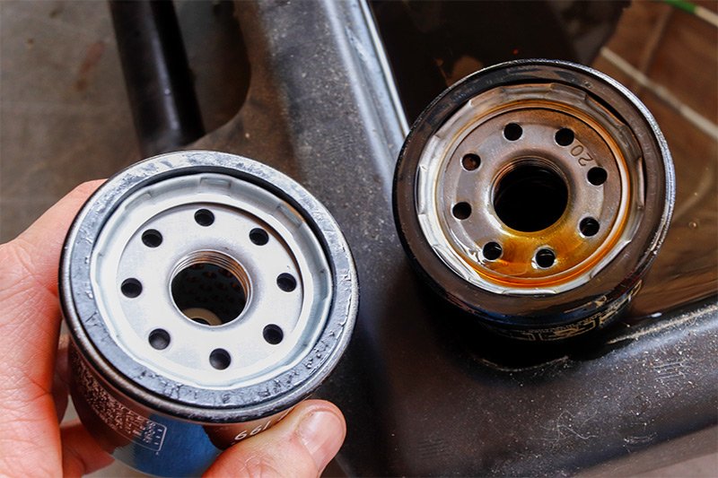

5. Next, I used the oil filter wrench and a 3/8 inch socket wrench to loosen and remove the oil filter.
6. I dropped the filter in the same oil catch so the oil would drain from it.
7. I used the 17mm socket wrench to replace the filter with the Hiflofiltro HF199 and tightened that snug. Before I did so, I spread some oil on the rubber gasket to make tightening the filter down a bit easier.
