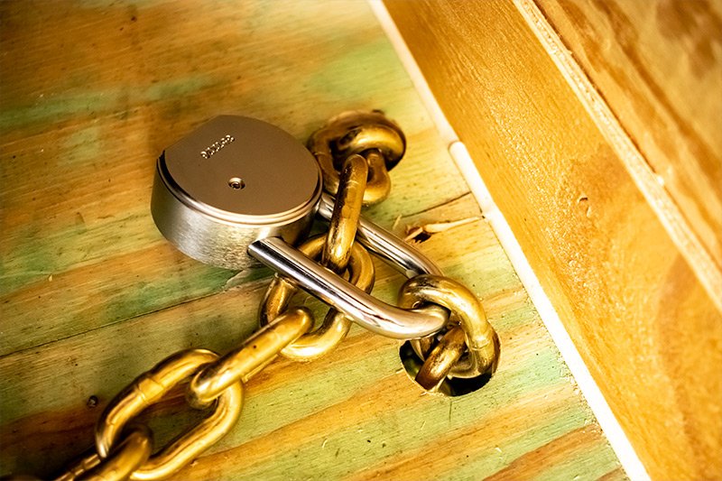

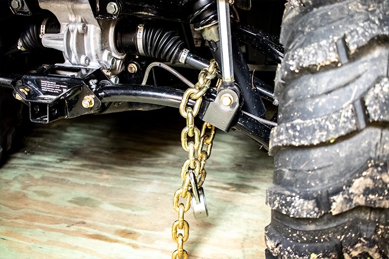

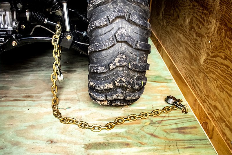

Okay, I answered my own question. After thinking about it for a while, I decided that I needed to lock the ATV to the frame of the trailer. No i-bolt screwed into the floor would make me happy. So all I did was drill two 1 1/4 inch holes in the floor of the trailer; one on each side of the steel frame cross member that runs underneath the plywood floor. Then, I used some 3/8 inch, 6,600 pound transport chain that I bought from Tractor Supply for a bit over $5 per foot to go down through one of the holes and under and around the frame and back up through the other hole. Then, I used my very heavy duty Schlage padlock that I just bought to lock that loop of chain together. After that, I ran the chain to the rear of the ATV and wrapped it around the rear axle and the a-arm. I locked that up with another padlock. By keeping the chain in a single run and using two padlocks, I was able to keep the chain longer and easier to work with. I've included some photos of my little operation below. Let me know what you think.
