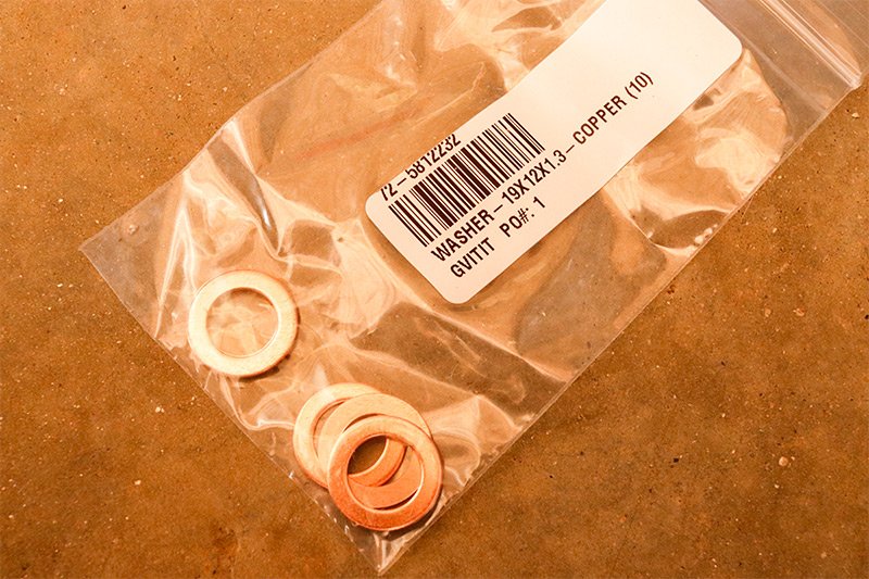

Before beginning this effort, I had to purchase a few things. The first thing I had to buy was some copper washers for the drain plug. With each oil change, it's necessary to change this washer. Because I'll be doing this in the future, I bought five washers.
5812232 WASHER-19X12X1.3-COPPER (10) (Polaris)
I bough these from Partzilla and I paid $1.51 each, for a total of $15.92 with tax and shipping. Just so you know, this is a huge ripoff for some dinky washers. I probably could have bought some from the hardware store if I had known the exact size.

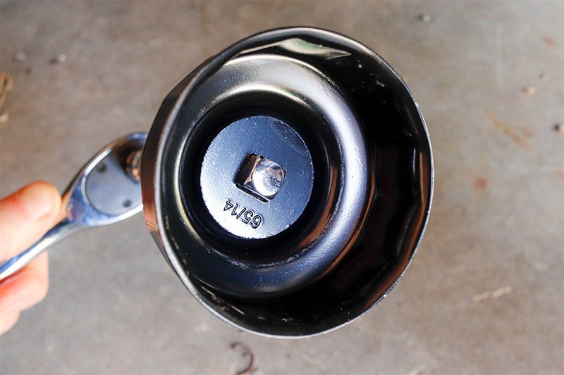

Next, I needed to buy an oil filter wrench. I ordered one from Amazon for $8.99 with free shipping because I have Prime. This is the exact part:
EWK 3/8 inch 64mm 65mm 14 Flute Oil Filter Wrench for Toyota Scion Honda Lexus
I can confirm that this filter wrench fits the Polaris oil filters.

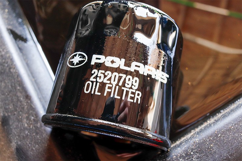

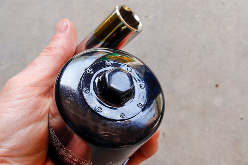

Finally, I bought an oil filter from Amazon too. Here's what I got:
Hiflofiltro HF199 Premium Oil Filter
This is a knockoff Polaris filter that fits these ATVs. It replaces the Polaris part numbers 2520799 and 3089996. I can confirm that this filter does indeed fit as well.

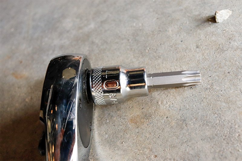

The only tools necessary to do the oil change for this Polaris Sportsman 850 are the oil filter wrench I described above and a Torx T40 wrench. If you're going to buy the same replacement oil filter as I did, you'll need a long 17mm socket or a short one with a socket extension.

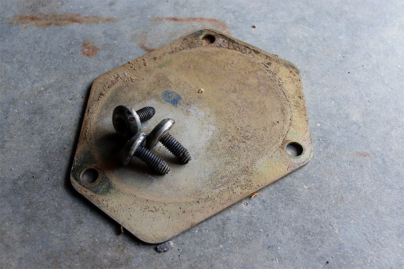

1. First, I used the Torx wrench to remove the bottom plate on the quad.

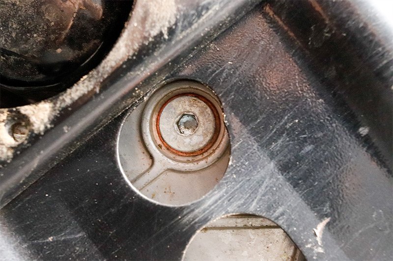

2. Then, I used the same Torx wrench to remove the oil drain plug. Before removing the plug, I place an oil catch under the drain bolt to catch the oil.
3. As the oil was draining, I switched the oil copper washer with a new one.
4. Once the oil was finished draining, I replaced the oil drain plug and tightened the bolt to 12 foot pounds.
5. Next, I used the oil filter wrench and a 3/8 inch socket wrench to loosen and remove the oil filter.

7. I used the 17mm socket wrench to replace the filter with the Hiflofiltro HF199 and tightened that snug. Before I did so, I spread some oil on the rubber gasket to make tightening the filter down a bit easier.
8. Once that was completed, I replaced the bottom shield with the three Torx bolts.

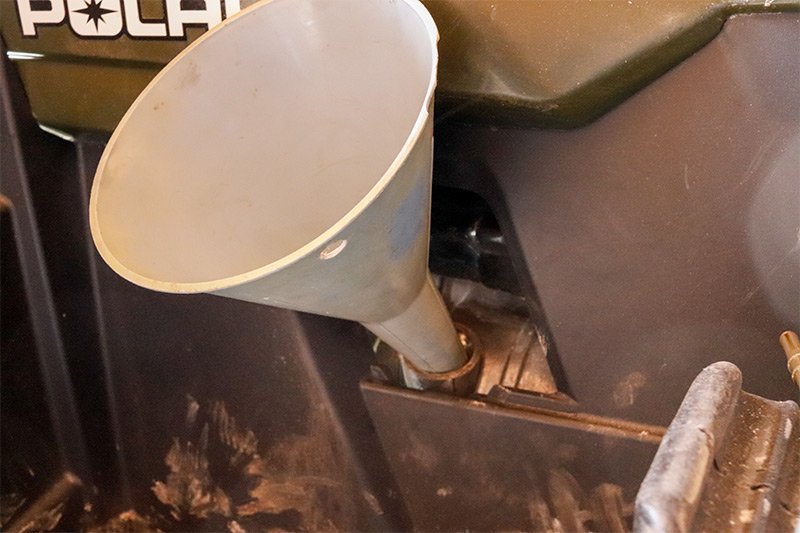

9. I then filled the ATV with two quarts (pretty much exactly) of new motor oil. I ran the engine for a few minutes and then checked the oil and it was to the proper position on the fill line of the dipstick.
